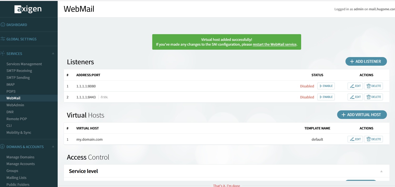

Hello, I need help and explanation.
I would like to access the WebMail website by entering my domain my.domain.com according to this : axigen documentation webmail-listeners-virtual-hosts-control-rules-p45254002
unfortunately it doesn’t work. port 443 is already occupied by Webadmin
I use the default template for the virtual host because I don’t have the files
<working_directory>/webmail/default
Debian 11
root@mail:/var/opt/axigen# ls
axigen_cert.pem axigen_dh.pem axigen_lk.bin aximigrator bitdefender domains filters letsencrypt log notifications queue reporting run serverData
default template folder missing!
with the current setting, my.domein.com points to the webadmin login page but with the wrong certificate
I will be grateful for any suggestion
