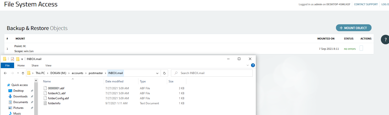

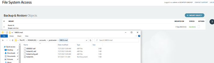

Please know that we tested in the past when the problem occurred with an older version of Windows 10. We recently tested out again with a newer version of the OS (please see below the version used) and we were not able to replicate the problem. Please see below what we have used:
Windows 10 version 21H1, OS build: 19043.1165
Axigen verision: 10.3.3.19 on both server and webadmin/webmail (we’ve also tested with a 10.3.3.1 version and the result was the same, the problem does not replicate)
Dokan version 1.3.1 (available at the link below)
