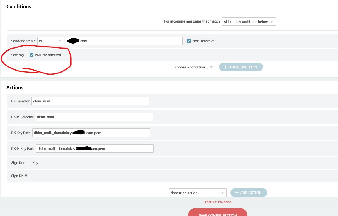

Usually each hosted domain should have its own signing rule.
However you may have a single signing rule and adapt it to use the same selector and private key for all domains.
This is easy to do by keeping only the following condition:
Connection is authenticated (ticked)
Hi Indreias,
I think, you said that it… Yes, I did it… But, DKİM is not working other domain…
remove sender domain condition and test again.

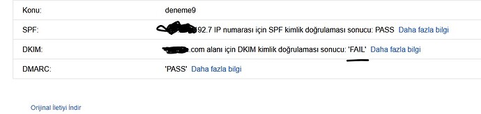

Yes… Now, I removed sender domain… and result : fail for 2th domain…

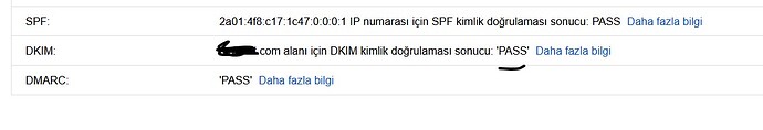

but, default domain result : pass

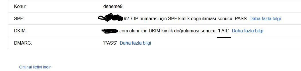

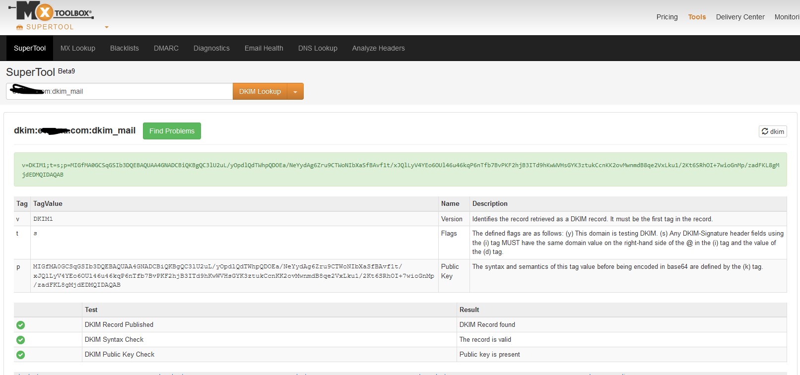

Dkim is true on mxtoolbox.com… But, Fail on Gmail…
I think, I must do something on server… TXT DNS record is correct. but gmail cannot verify. What should I do?

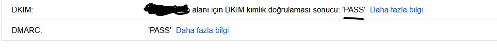

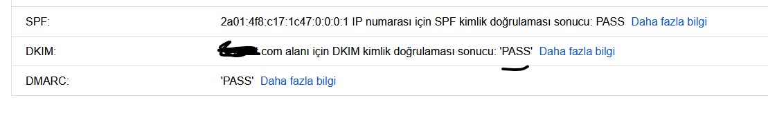

Now DKIM is approved by gmail.
I was making the mistake.
I want to write my mistake here. So that others do not make the same mistake.
I thought that a separate DKIM would be created for each hosted domain. No. You should use the DKIM you created for your default domain for the hosted domains. And you should enter DNS TXT for each domain you host. You can find the necessary steps for Gmail approval on this page of Axigen. The necessary file should be on your server as in this link: DNS Configuration | Axigen Documentation
