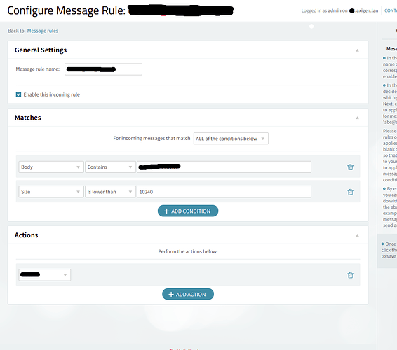

Please know that we have noticed that you have 4 different rules that have as condition to search the message body for a specific text.
We would like to mention that when using sieve rules to filter the body of the messages it is strongly recommended to perform the filtering only if the message size is small because for (very) large messages this type of filtering is expensive in terms of resources and can cause slowdowns in the processing of the entire queue.
To do so, you may add an additional condition to each rule so that the rule applies only if the message size is lower than a certain value (10 KB) in our example. We attach a screenshot. It is important to select “ALL of the conditions below” at the top of the Conditions section.
