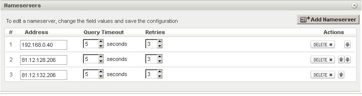

What dns servers do you defined in DRN Service?
If you use local DNS server you also need to create SPF record in it.
I use local DNS server and added to DNR Service.
DNS server isnt installed on axigen machine.
you need to create an SPF record in your DNS server (192.168.0.40)

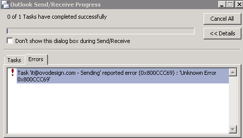

  2. I cant send any email if activate SPF check. See attached photoCapture
    Also i not receive any email after activate SPF check.Logs.zip (156.8 KB)

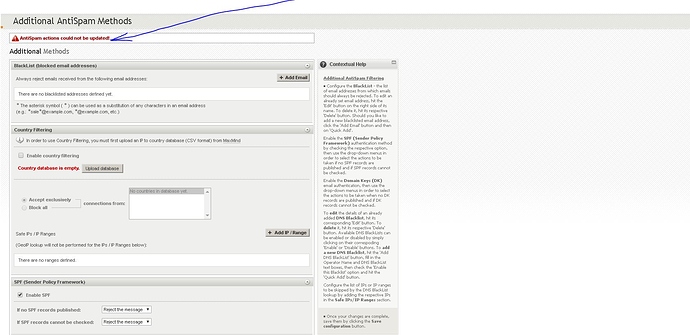

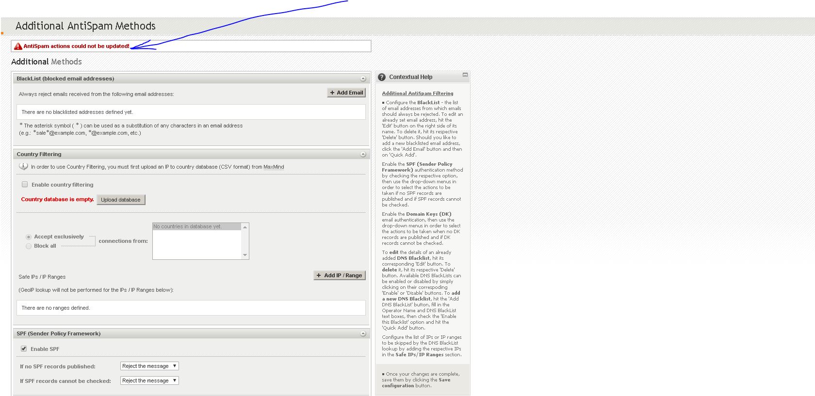

  3. I cant select deliver the message If add in smtpFilters.script file to function event onMailFrom this lines
    call (checkSPF);
    ** call (WA_AntiSpam_SPF_Err);**
    ** call (WA_AntiSpam_SPF_None);**
    After change smtpFilters.script in web admin If no SPF records published and If SPF records cannot be checked cannot be changed because by default option is set Reject the message. I can select Deliver the message but not save

Hello Costel,
I’m sorry if you could not select “Deliver message” for both “if” conditions from SPF setup. It is a clear sign that you have to upgrade to the latest available version (Axigen 10.2.2), most probably via “automatic migration” procedure.
